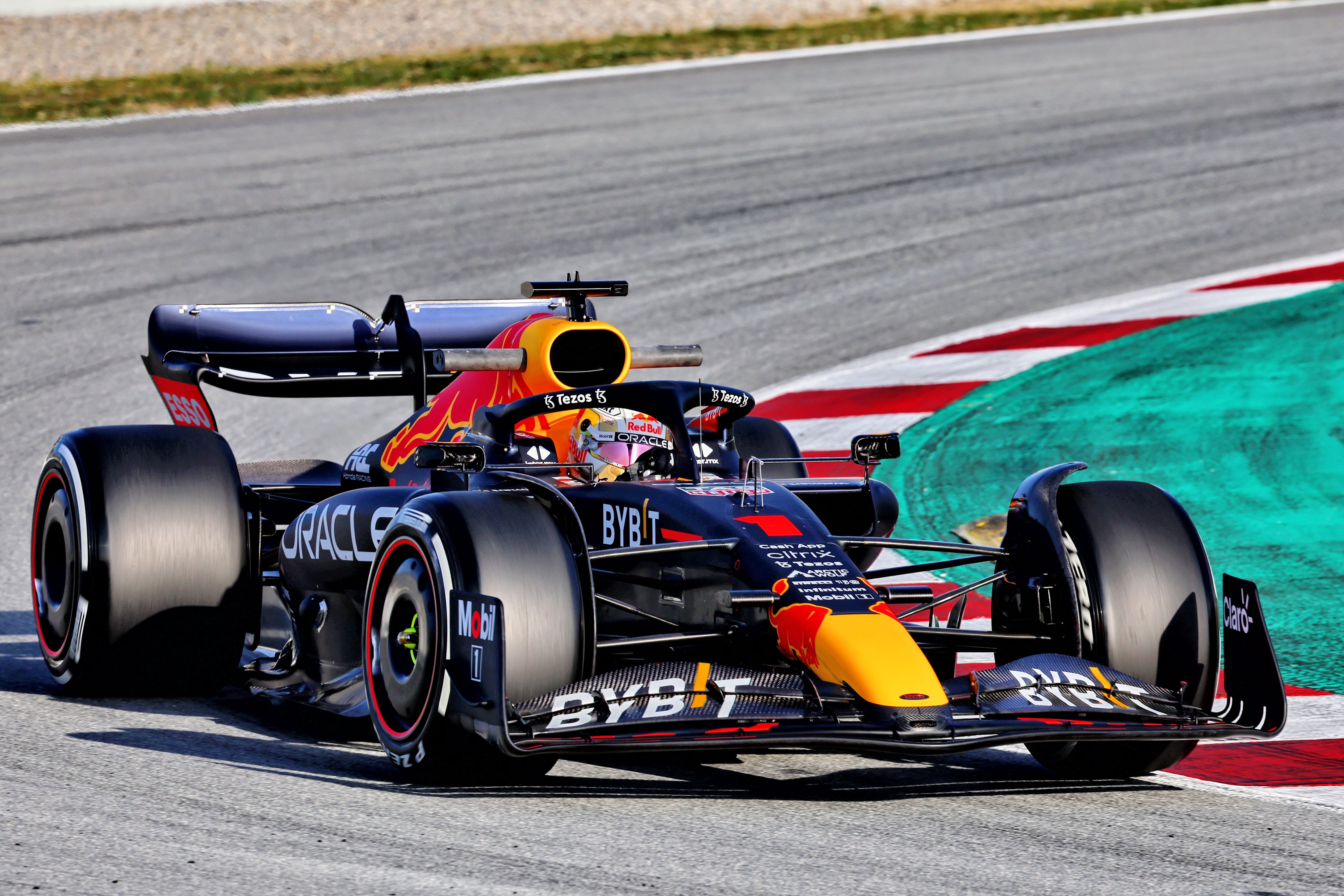

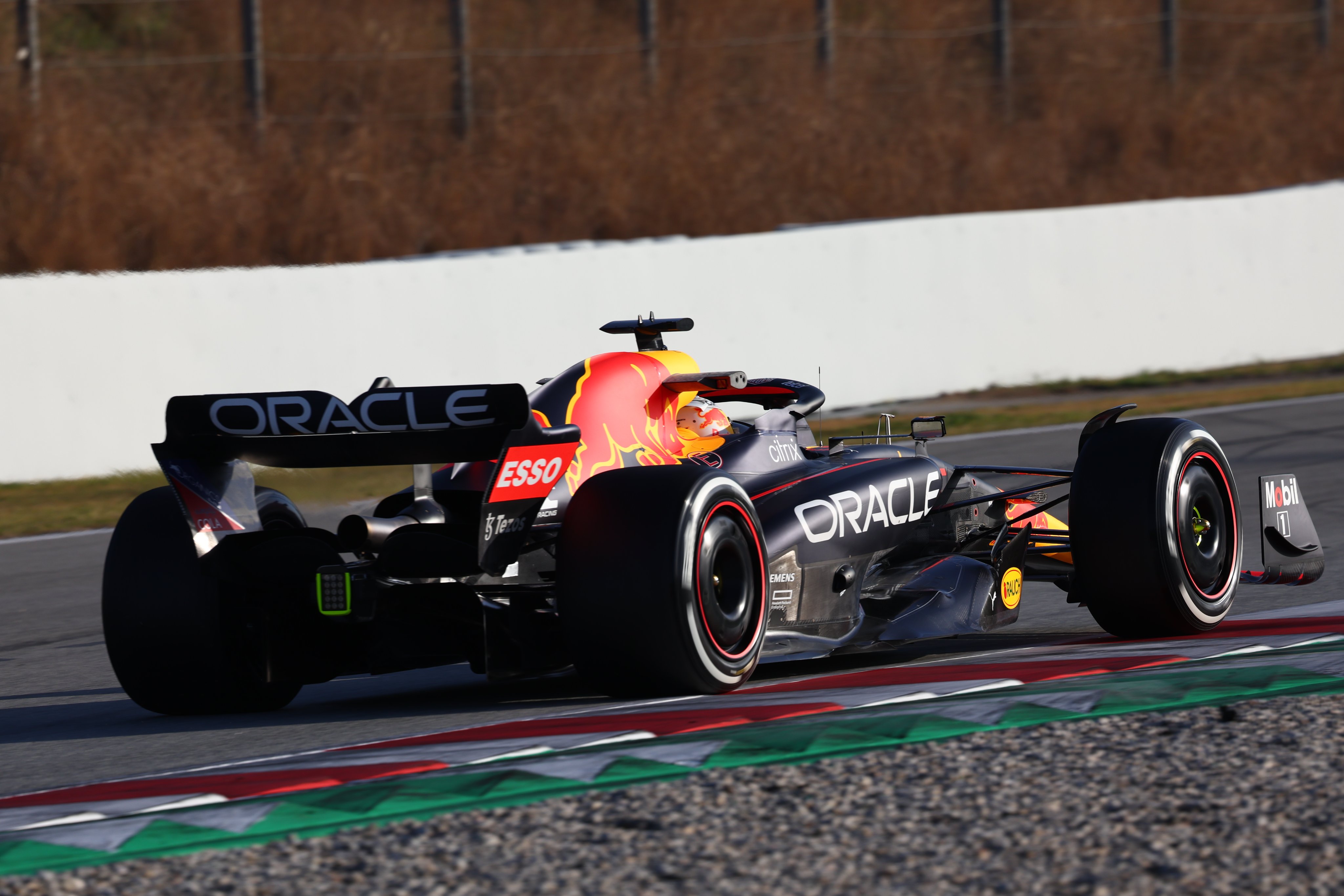

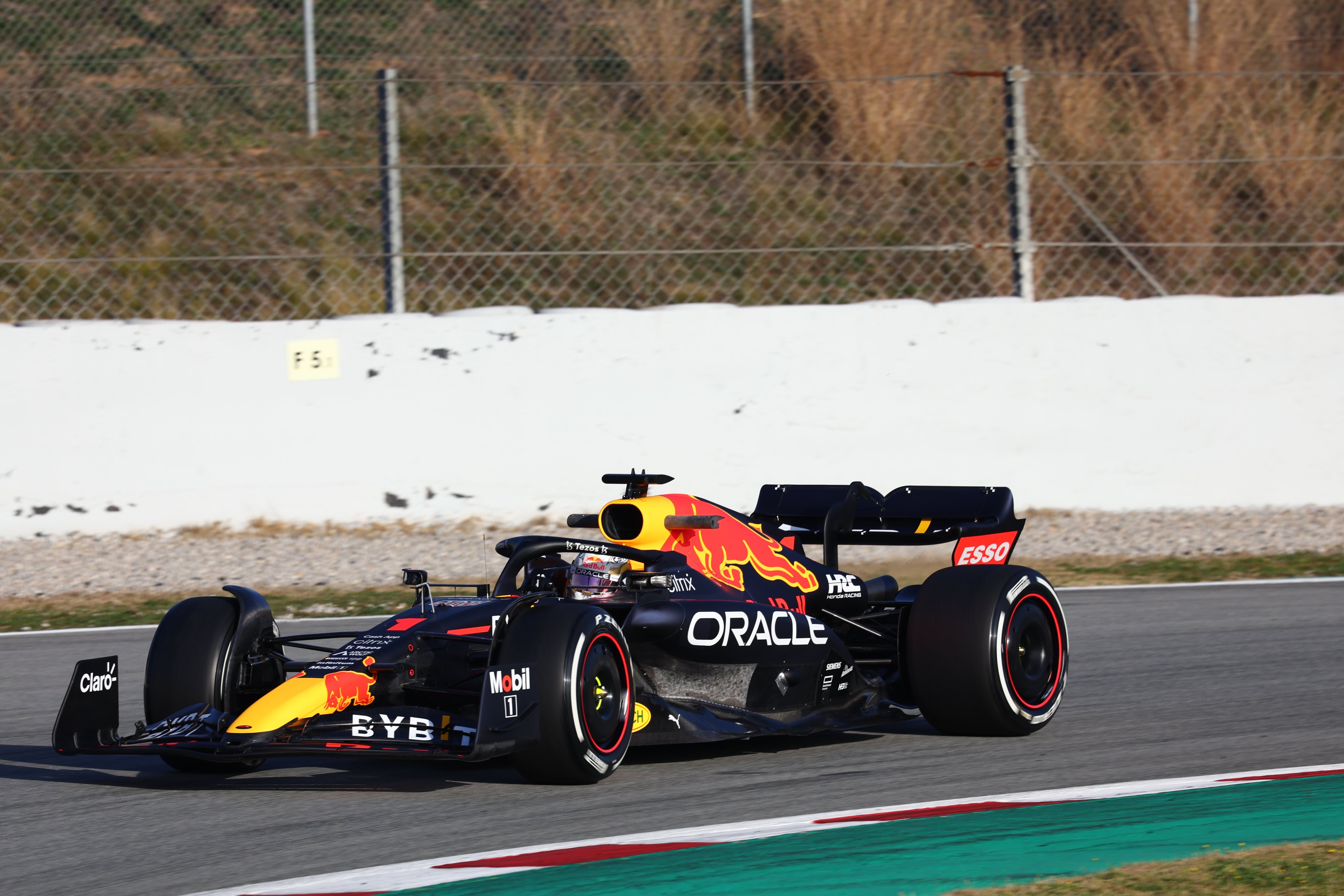

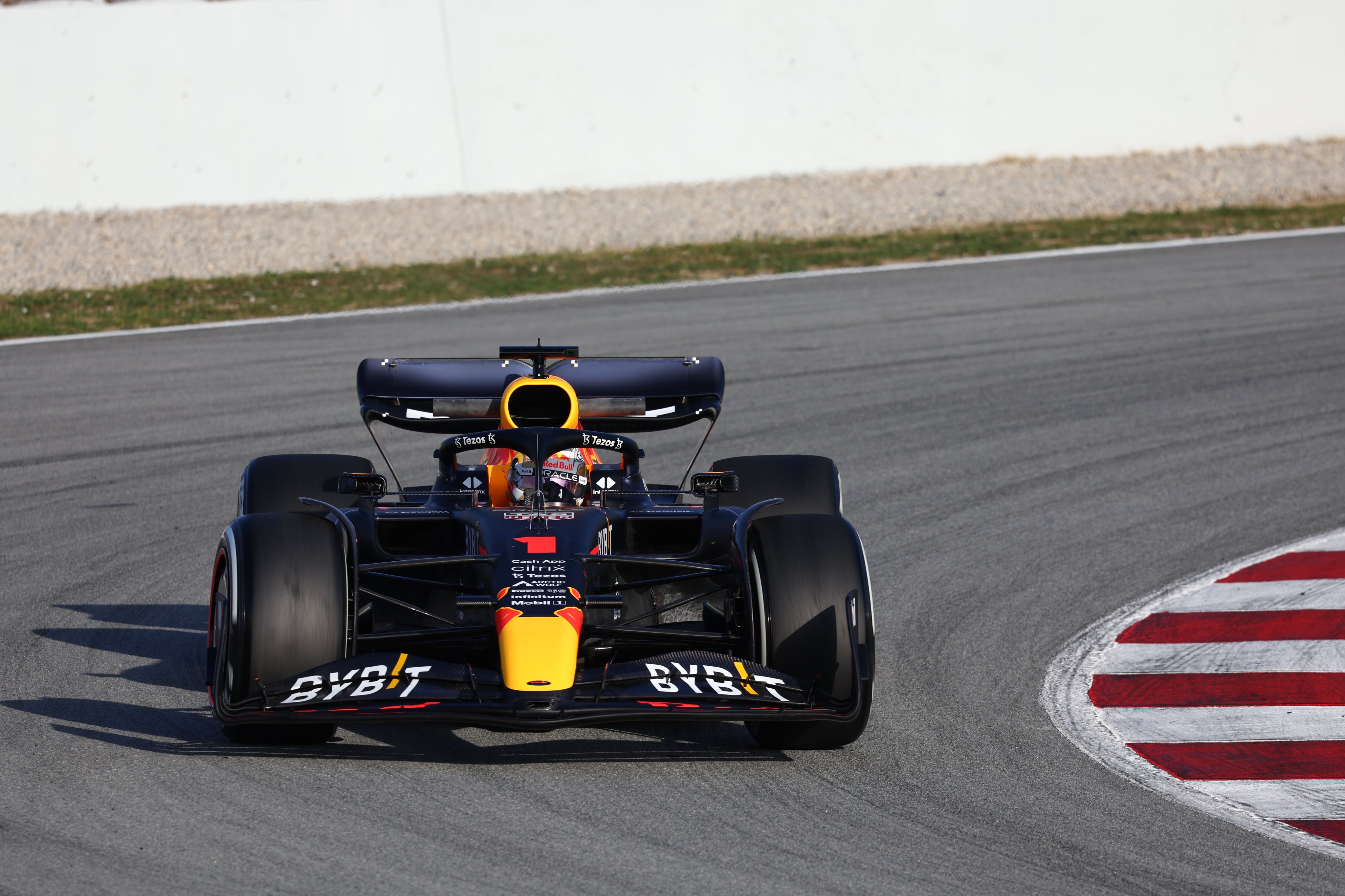

RedBull have gone to extremes to push the front tyre wake outwards. The double blade bargeboard outer strake, the extreme undercut with the sidepod maximum width a long way back. The bottom lip of the sidepod intake helping create a long channel.
It's going to be interesting to see if this car is difficult for others to follow - It's the most extreme attempt to flout the "no throwing the wake wide" rules so far.
