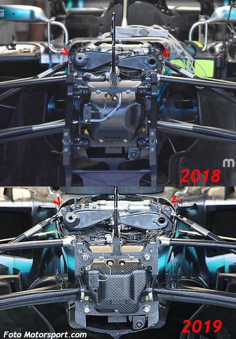

Can anyone explain the benefit the advantages of mountings having been moved upwards? Allison mentioned in his 2018 vs 2019 comparison video that, they didn't know they could go that higher and they have achieved it now. There must be some real benefit of having done that.
Suvesh
Suvesh
Joined: 11 Mar 2019, 14:54
Re: Mercedes-AMG F1 W10 EQ Power+
GPR -A wrote:
26 Mar 2019, 14:42
I think it allows more clean airflow (unaffected by interference from the wishbones) to pass through to the sidepods and towards the rear of the car, allowing better cooling and cleaner air to generate downforce.
386
Joined: 16 May 2011, 15:18
It can also give you better motion ratios with smaller pushrods as the forces are lower from the increased angle.
But that would be a secondary benefit, it's mainly aero driven.

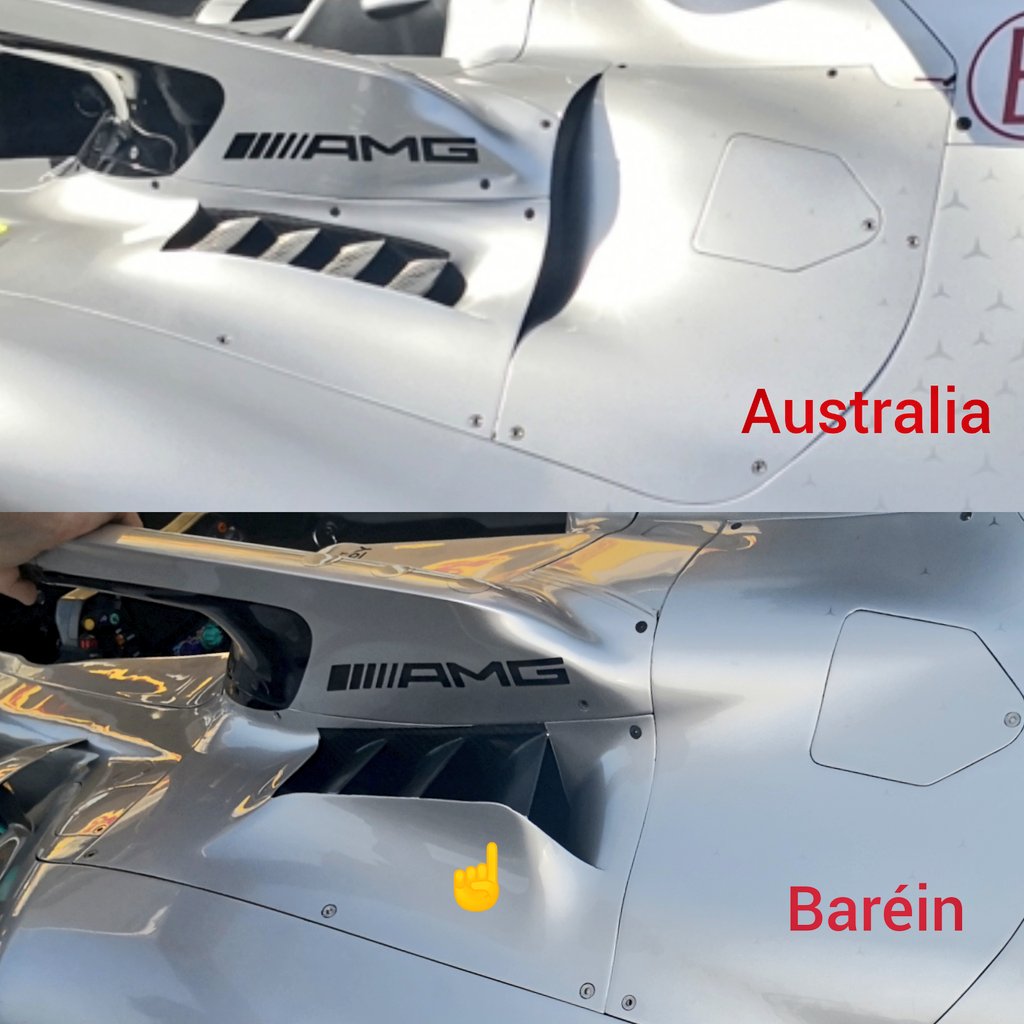

Via @AlbertFabrega
