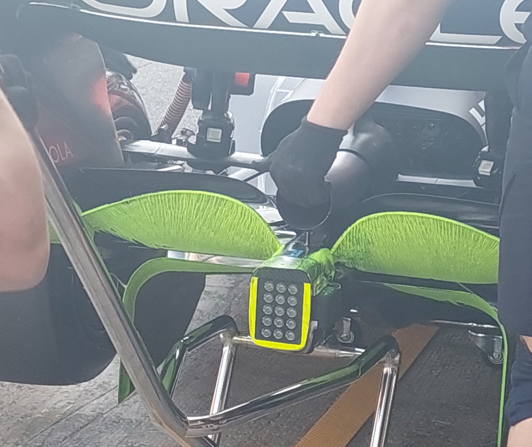

Maybe that's why they have to use the engine cover with cooling slots. :-)
https://cdn-1.motorsport.com/static/img ... 079835.jpg
Im pretty sure the cooling outlets sit on a different panel that can be removed individually.
You are right, you can actually see the repairs (behind the oracle lettering in the blue part) the best, if you zoom in a bit on the picture posted.
The panel just got ripped from the added pressure of the rearward facing camera mounted there.
Agreed. You can still see the damage on the L of ORACLE on the image with the louvres
