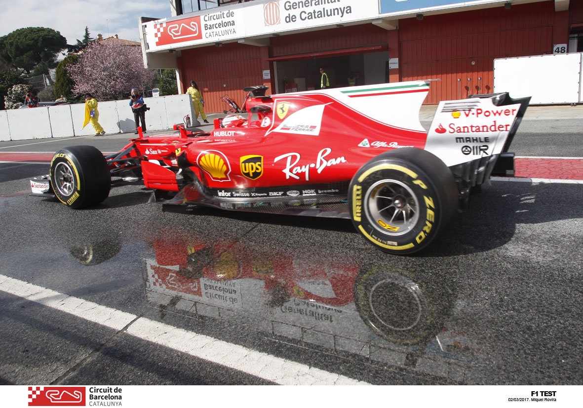

Mr.G wrote: Does anyone have some info about the strip in the floor and why they measuring the temperature there? I found only some speculations. From them the most reliable seem to be piping for the gearbox cooling...
Here is another speculation: Cables from/to batteries.
Cables to where? MGU-K/H are mounted to the ICE...
edit: adding picture
Mr.G
34
Joined: 10 Feb 2010, 22:52
Location: Slovakia
Re: Scuderia Ferrari SF70H
Can it be heating the floor to make it bend? I don't understand the shape, if it was for cables/piping why do it i such odd shape? You can make it shorter.
386
Joined: 16 May 2011, 15:18
The only thing I can think it's they're the hydraulic lines to the accumulators in the sidepods and they've put them in the floor to let the airflow cool them - perhaps instead of using a seperate small oil cooler.
PhillipM wrote:The only thing I can think it's they're the hydraulic lines to the accumulators in the sidepods and they've put them in the floor to let the airflow cool them - perhaps instead of using a seperate small oil cooler.
Or, they've painted some black lines on the floor and stuck some spare temperature strips on there to send the other teams on a wild goose chasse? :lol:
It was on the launch pictures too...
