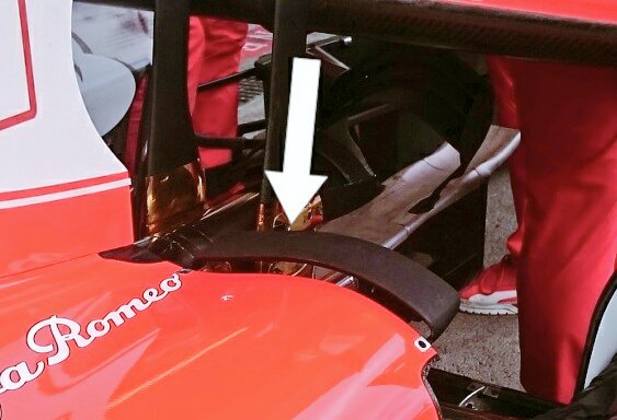

interesting addition at the end of engine cover, shaping airflow from under engine cover towards rear?

Mercedes has something similar in this area.
Re: Scuderia Ferrari SF70H
Via @AlbertFabrega
#TechF1 @ScuderiaFerrari introduces a mini-flap on the trailing edge of the sidepod/engine cover cooling outlet - via @Giorgio_Piola
Almost looks like a beam wing of sorts.
That is actually a type of T wing. An ugly bastard of a T wing that actually looks not so ugly in the full view of the surrounding bodywork?
1735
Well spotted, Zealot... It definitely looks like those wings are in the non-mandated zone...
