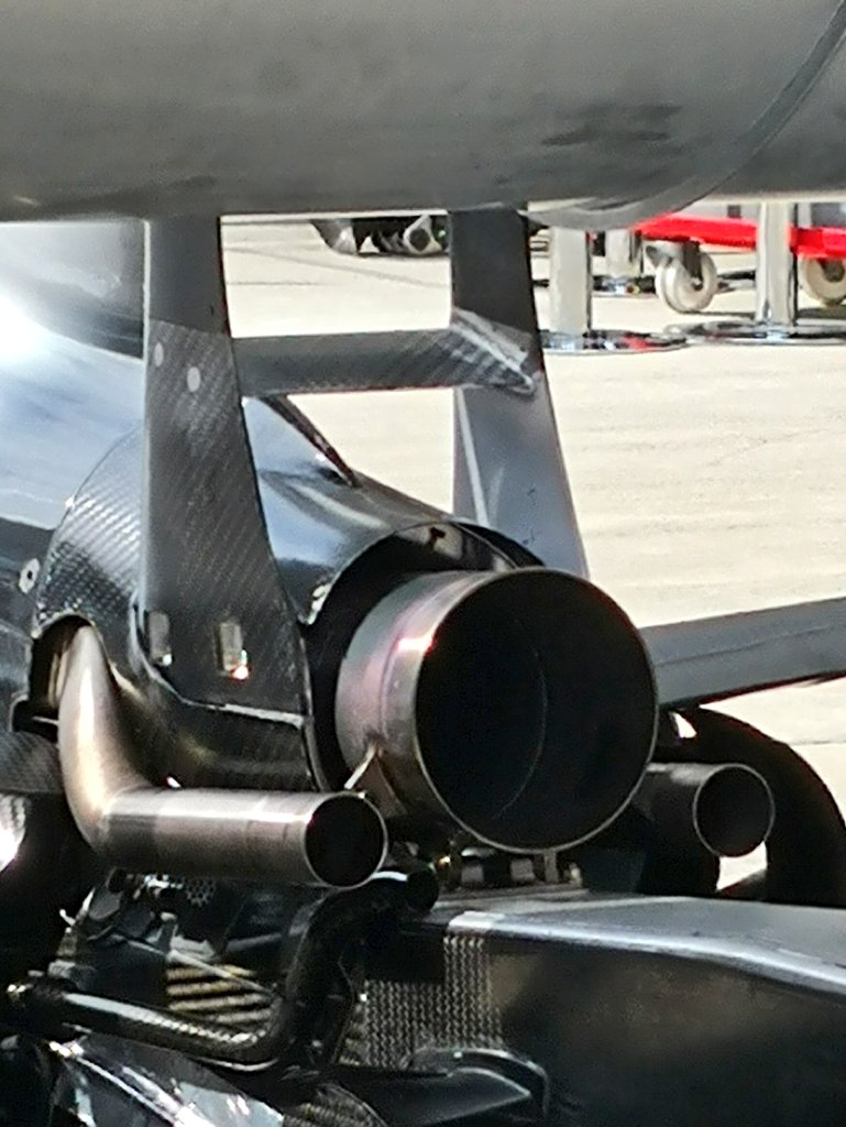

Seems like they should rotate their wastegate support tabs 90*, but I'm sure they have their reasons. Also the crankcase breather is visible in that first photo. The carbon pipe below the left wastgate pipe.

Is that a downwash wing in between the two swan neck mounts? Right where the mounts change from smooth black to a carbon weave.
May not necessarily be downwash through that region; more 'neutral,' as a flow straightener/conditioner, in-line with the downward flow present at the front lip of the rear wing. And it's primary function may be as a structural member. Also, might the color change imply that the top half of the supports is painted metal, the lower half CF?

Is that the FIA mandated engine mic under the left wastegate pipe?
I wouldn't think that Mercedes would go out of their way to paint the upper half of the supports for livery reasons. So I agree, it must be a different material. But why would that be? Any forces traveling from the wing into the chassis will still need to pass through the carbon so this change must not be for structural reasons. Could the top half be made of a more flexible material that will allow the wing to flex a bit?
Do you mean the small circular device with a bunch of small openings in it towards the bend in the wastegate pipe? Yea, I believe that is the mic you're talking about. Mercedes was experimenting with the mic location earlier in the season and this is the general location they tested. This must just be the final resting spot for it.

The tube? That's the crank case breather that must now vent at the rear of the car.

Sorry I wasn't clear... as jh199 mentioned, the device that is just under the last bend of the wastegate pipe. So it's just under the first few cm's of the horizontal section of the wastegate pipe.
I also saw the same device in a slightly different location on the Toro Rosso (under the main exhaust outlet), so it must be the mic.
