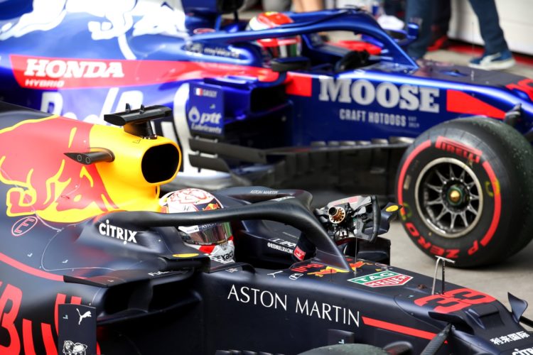

No Zibby you stand corrected.
RB15 had the contoured BULL HORNS.
SPA 2019 RB15
Brazil 2019 RB15 (notice the STR14 in the background, its not a 2020 photo)
The article clearly states that the bull horn shape of the W11 is now like the RedBull's which they already had last year.

dans79
267
Joined: 03 Mar 2013, 19:33
Re: Mercedes W11
One of the great things about the forum is being able to go back and search the car threads.
Horns first showed up on the W10 on Tue Feb 26, 2019, a photo of them Via @AlbertFabrega was posted by @Morteza.
viewtopic.php?p=816567#p816567
they didn't show up on the RB15 untill Thu Jun 06, 2019 as can be seen here.
viewtopic.php?p=838344#p838344
So RBR didn't have horns until over 3 months after Merc!
