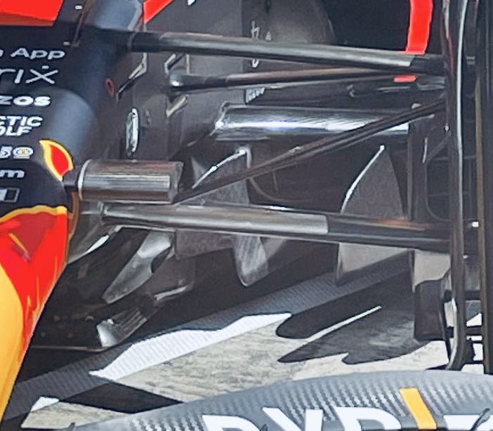

Re: Red Bull RB18
Red Bull continue their iterative development of the front brake duct cooling. They have been updating this area continuously from the beginning of the season.
This new deployment has more curvature and detailing which suggests to me they're arriving at the performance level desired of their brakes. Not seeking radical redesigns but optimization

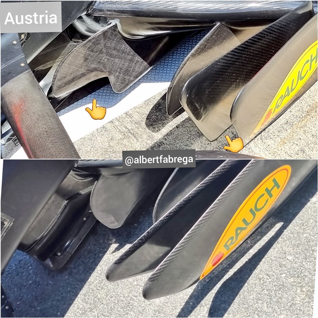

Unfortunately don't know the source of images as found on Twitter, but the fence leading edge has seen some revision:
Interesting new shape of the inboard fence leading edge
The outboard strake doesn't look too different to me, but the pictures I have point to it because whoever added the emojis thought it was different - probably just angle

Re: Red Bull RB18
And another angle of the floor
Re: Red Bull RB18
Hmm that's pretty cool. Similar to Haas' cooling exit beneath their fin
New inboard fence extends significantly further forwards than before
Another angle of new floor leading edge geometry
Looks to me like the red line might be the original geometry and they've bonded on the blue highlighted section hence why it's stepped? Feels like in the original image & Fabrega's image there's a discontinuity in the carbon weave along the red line which I drew which suggests this theory could be true, or I'm seeing things Image
