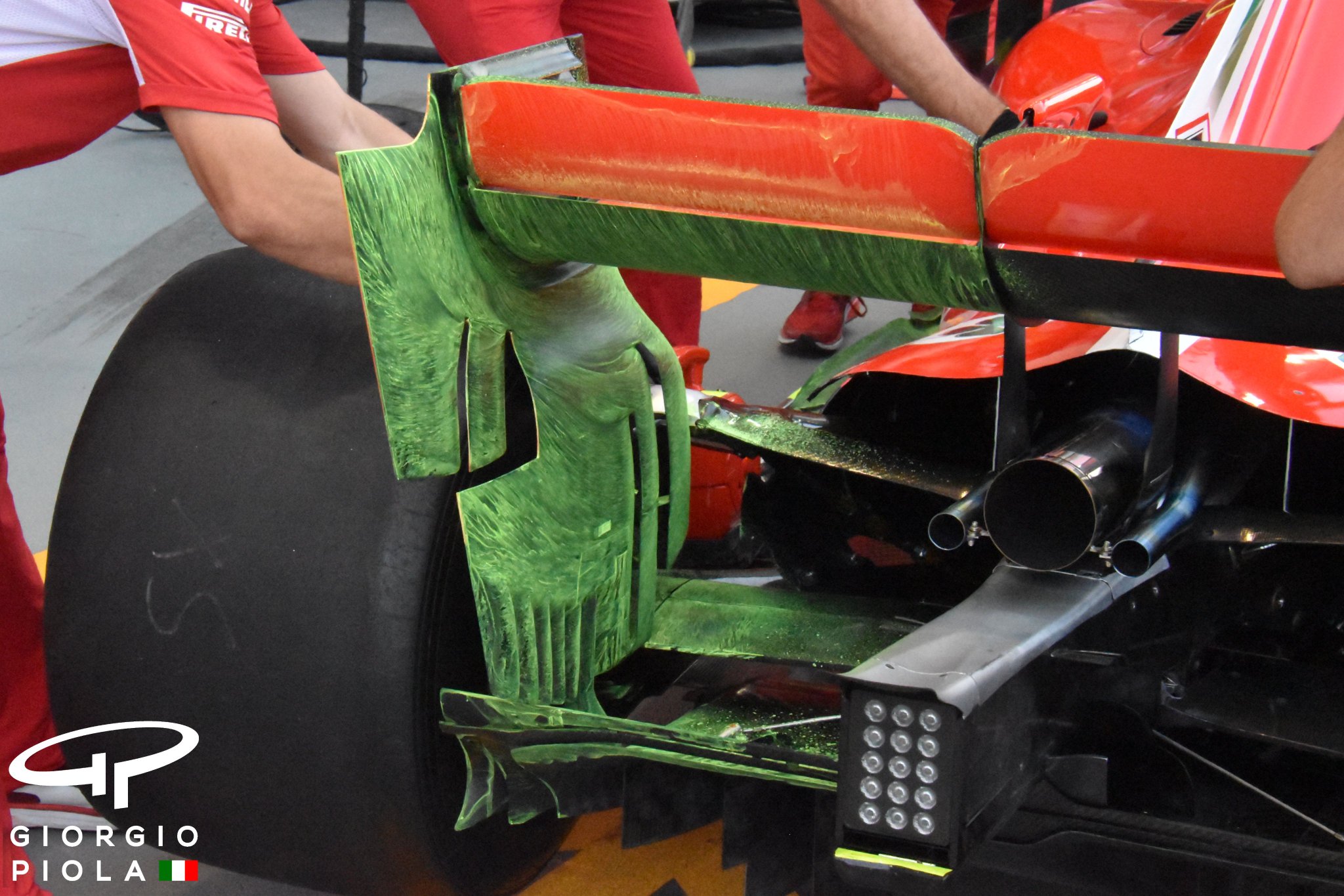

Some flow-viz pics from Racecar Engineering:

Bit of trailing-edge region flow separation showing the rw flap is running at/very close to its limit in terms of usable AoA.

Looks like a near vertical vortex forms inside the endplate, sprouting from the first main louvre.
Vortexes form at the tip of a surface though. This highlighted area just indicates laminar upwash.
