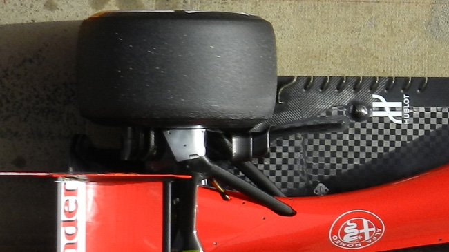

What could be the reason for them to dump the combined lower wishbone at the front? Weight?

jetho wrote:What could be the reason for them to dump the combined lower wishbone at the front? Weight?
New front suspension .. push rod

Re: Scuderia Ferrari SF16-H
Merc and RB also use push rod front suspension and run a combined lower wishbone. I get that Ferrari switched from pull rod, but for some reason they chose to abandon the idea. Aerodynamically it should be better to run a combined wishbone.
