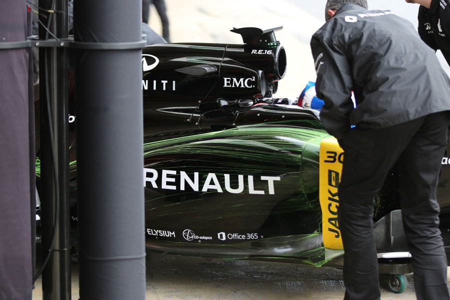

It's about cleaning up the flow coming from the front wheel, separating it from flow coming around the undercut from the barge board. You can't stop air flow over the sidepods ; if you did that you'd be creating a vacuum which, of course, is a bad thing. (Not really a vacuum of course but an area in to which air will rush anyway.) These side pod treatments are about getting the right quality of air to go where you want it. The air will flow over the top of the sidepods - you can't stop that. You can try to ensure that the air going over the sidepods is "clean" in order to help the rear wing and the diffuser.
Different car but look where the air flows:
Please try to restrict your comments to actual items that are on the SF 16-H.
The air on the shoulder will move up on to the side pod and that's not a bad thing as it clears the way for air in the undercut to flow around to the diffuser roof. The air flowing over the side pod is nice and clean, sure this generates some lift but it is low drag and it helps the rear end. The result is a net gain in downforce from the car. L/D rises which is a good thing.

The reason I used a picture of the Renault is because I couldn't find one of the Ferrari with flo-viz on the side pod. If I could have, I would have. It's difficult enough having technical discussions on this site these days without being picked up in this way.

Just_a_fan wrote:It's about cleaning up the flow coming from the front wheel...
The idea is the same as what's seen below. It just uses a pressure gradient instead of vortex generators....
It's also been Ferrari's design philosophy since 2014.
I guess a better way to make my statement would have been to say that it helps redirect topside air flow over the flanks of the sidepods in a way that likely minimizes lift.
Also remember that the context of my post concerns the leading edge indentations, not necessarily the turning vanes.
(The photos obviously depict other cars, but they're nonetheless illustrative of SF16-H's concept.)

It would be useful if we could find a flo-viz image of the 16-H. Google hasn't thrown up anything for me yet. Likewise the W07 as that was compared by you earlier. Sadly, I fear the teams haven't been very helpful on this issue! :lol:
