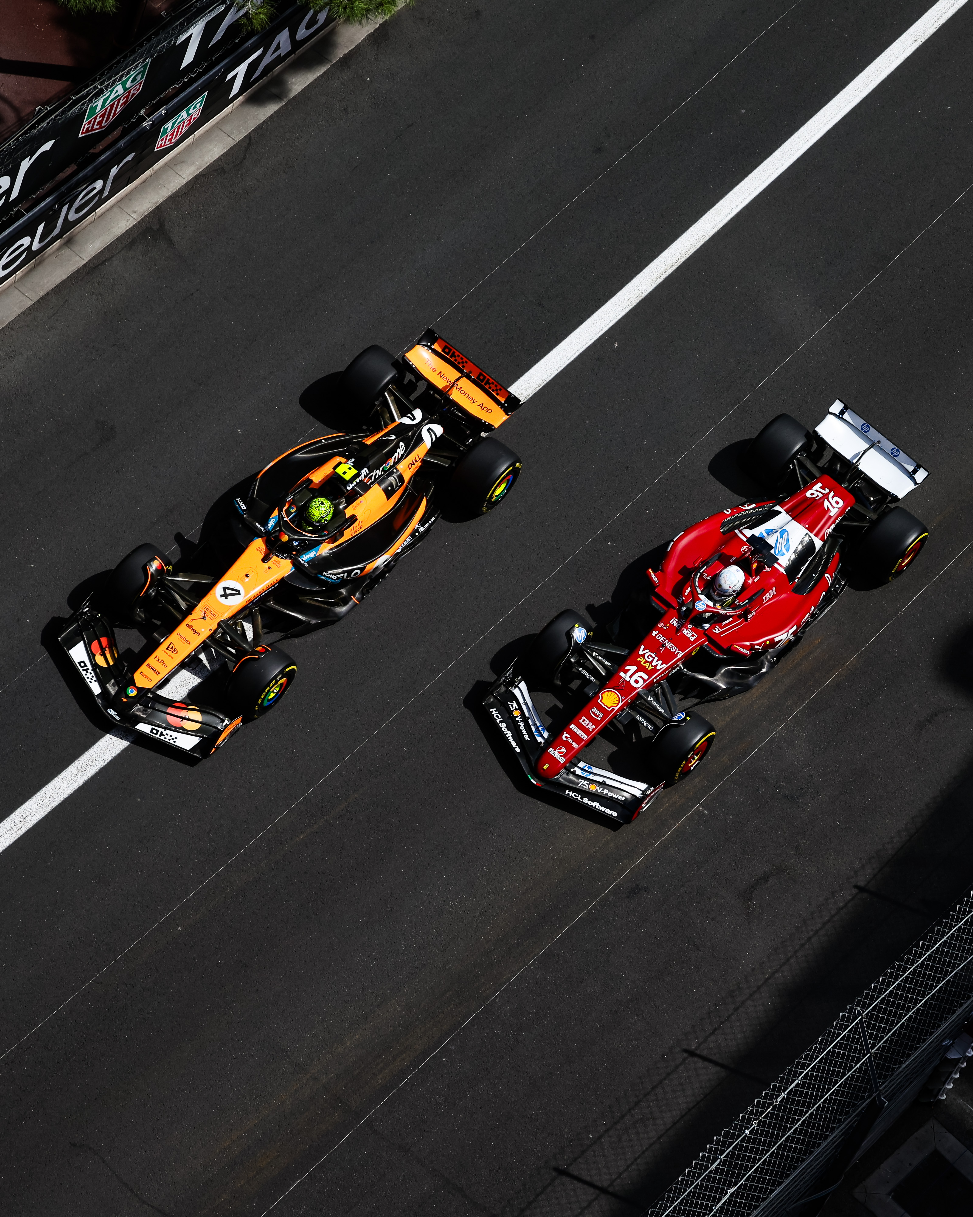

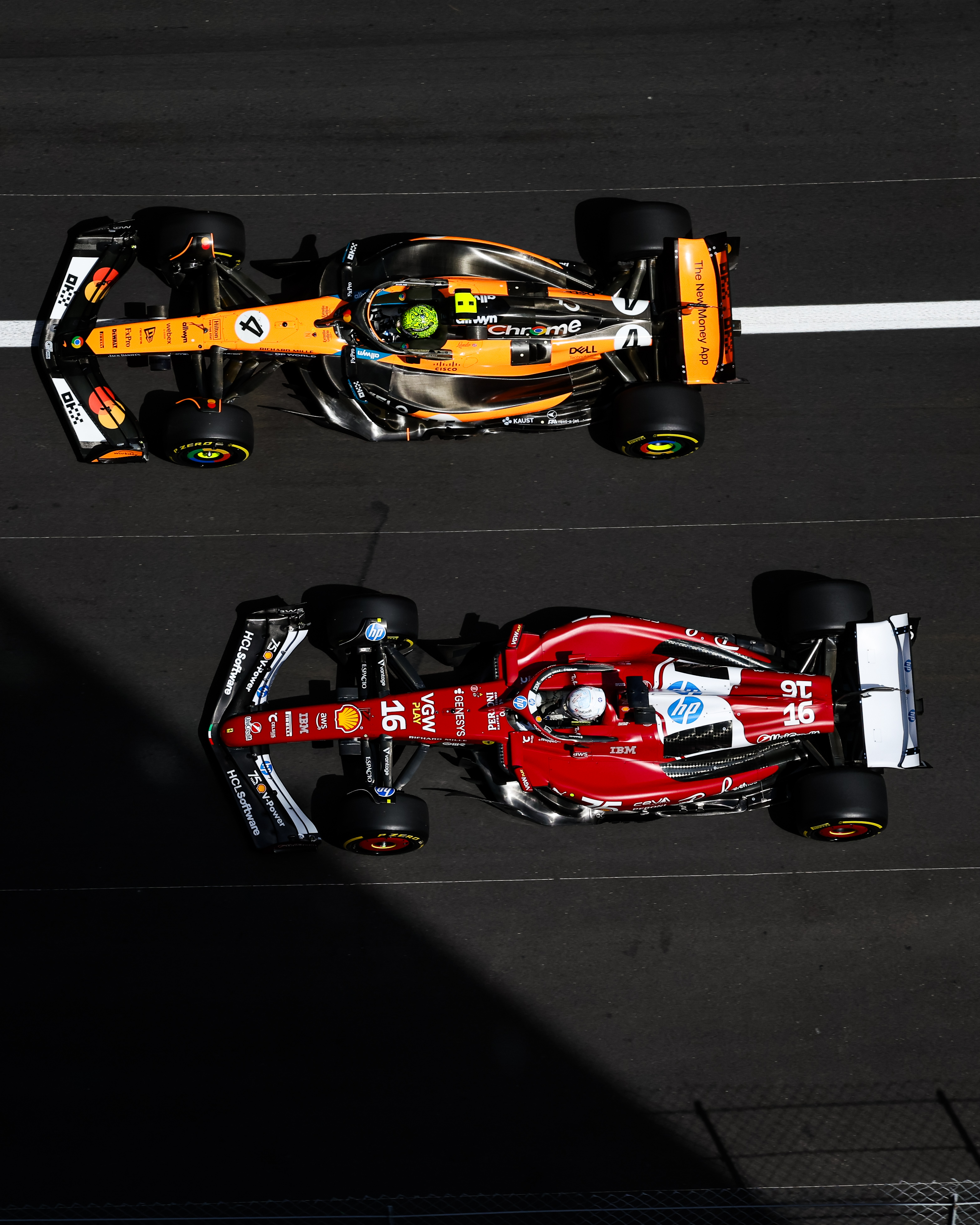

Re: 2025 car comparison thread
SilviuAgo wrote:
27 May 2025, 13:33
MCL39 vs SF-25, aero view in Monaco
https://pbs.twimg.com/media/Gr5KA3AWoAE ... =4096x4096
https://pbs.twimg.com/media/Gr5KA2-W4AA ... =4096x4096
source: unknown
I tried to put them side by side with Photoshop :

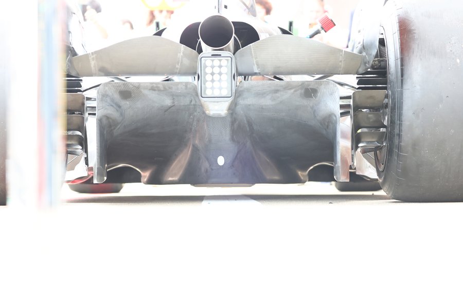

McLaren
Mercedes
@carpentiers_f1
It's surprising that Mercedes persists with the rectangular tunnels. I thought most teams had moved away from this.
Brahmal wrote:
09 Jul 2025, 03:41
Maybe It shows a lack of understanding in the Mercedes camp. After last race, wouldn’t be shocked if there was any immediate rearranging within the team.
