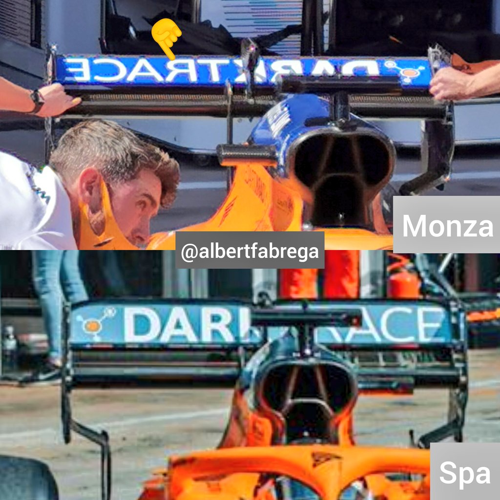

Re: McLaren MCL35
Seems like a lot less downforce than Spa. Renault in the other hand had a similar wing for Monza to the one they had in Spa, so quite a bit more than McLaren have here I would say. Hopefully the car is gonna have enough downforce to be quick on the straights and not suffer from tire wear on the race.

Chicane wrote:
03 Sep 2020, 14:53
The optimist in me believes that for McLaren to have enough confidence to go this low, there’s a good reason. Hopefully they’ve brought some other bits and pieces, maybe the mechanical elements they tried out last week? (I don’t know if they stayed on throughout the weekend) Fingers crossed they’re able to fully exploit.

Re: McLaren MCL35
I had said before Spa that the 'normal' traditional downforce settings for various tracks has changed in these cars. The wing levels needed are reducing with the sheer amount of downforce these cars produce from the floor and diffuser.
Silverstone was a medium-high downforce track traditionally but this year a low downforce setup was faster during the race. Spa went from Medium to low. Monza will go from low to ultra low. The way teams used to attack the setup work has changed big time.
Good to see Mclaren actually attempting to go really low downforce here. In a F1 car downforce is important but what is even more important is balance and efficiency. A car which may lack a little in downforce but is balanced to drive and has better aero efficiency will produce quicker lap times, better consistency and better tyre life. I hope they nail this setup this week so that they can start to match Renault in the low downforce configuration. In the medium to higher downforce setup Mclaren already have a very good base.

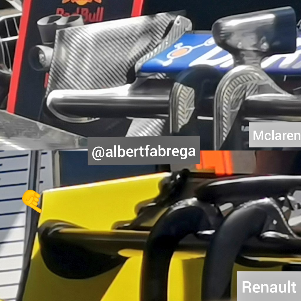

Re: McLaren MCL35
So Renault have gone for more wing but using a "Spoon" configuration and Mclaren has gone for less wing but a flat configuration. Let's see which one is going to work better.
