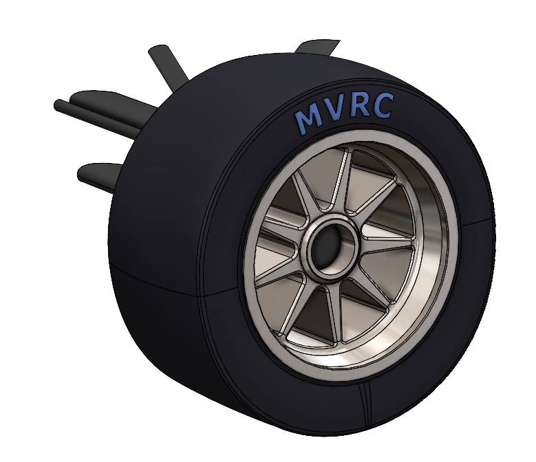

Hi, here is the first attempt to model a 2022 wheel.
Consider that in our simulations wheels are not "static" and the effects of downforce deform the rubber and make it a bit different from an almost perfect cylinder.
The modeling of the deformation is not accurate (it will never be very accurate, but in this case it is a pure guess).
I have doubts about the tyre width: I was convinced that front tyres in 2022 should be narrower than in 2021, but from the official rules it looks like they preserved about the same width (can anyone confirm that?).
On the contrary the diameter increased a bit.
I also have doubts about the orientation of the suspensions arms section: F1 rules allow a small angle of incidence, but each teams uses different angles. What about our cars? Neutral profile? Small positive incidence?

CAEdevice wrote:
Sun Apr 11, 2021 12:09 pm
https://www.caedevice.net/SERVER/MVRC/2 ... 210411.jpg
Fronts are 270mm tread/~350mm section width, rears are 405mm tread/~455mm section, tyres are 725mm diameter. Front suspension arms could/should be inclined so they are nose down because of the front wing wake, rules say up to 10deg nose down. Personally I never bother with tyre squish unless I know the actual geometry of the tyre - it's inaccurate regardless.
2022 cars will have the rotating wheel covers which IMO should be used to reduce the mesh count inside the wheel.

There is this PhD thesis with geometry from a scanned wind-tunnel tyre I believe, though its a few years out of date: https://core.ac.uk/display/16281043 fig 4.5

Thanks LegendaryM, sounds interesting.
In the MVRC case I prefer a simplified approach because each car will have different downforce and it would be too complicated and iterative (despite not impossible) to parametrically adapt the deformed tyre geometry.

No deformed tires please. Also please do not cut them off at the ground plane. It is better for the plane to intersect the geometry than to have a plane that only touches, or worse, is 1e-6m below the tire contact patch.

Re: [MVRC] Mantium Virtual Racecar Challenge 2020 (Grand Prix Cars)
Ok , I can set to flatted fapart of the deformed tyre 1mm below the ground l, but if you prefer not deformed tyre at all, no problem, it will be even easier to model.

CAEdevice wrote:
Mon Apr 12, 2021 7:38 am
A little bit is ok and actually very good as a completely round tire would be a bit unrealistic, but the CFD domain should define the plane that cuts the wheel off.
