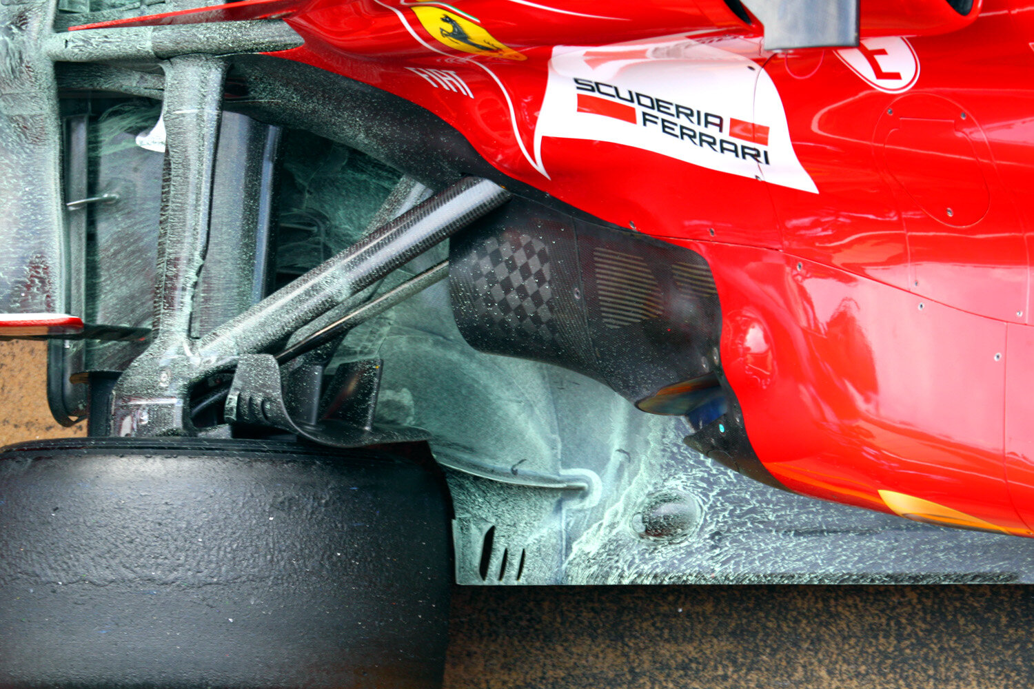

Is it me or have I noticed that the rear package of the F138 is quite tight/effective, flow viz to me shows good flow seperation and clean air flow along the beam-wing and rear brake ducts/drum.
If I'm wrong please don't be afraid to point it out :)
