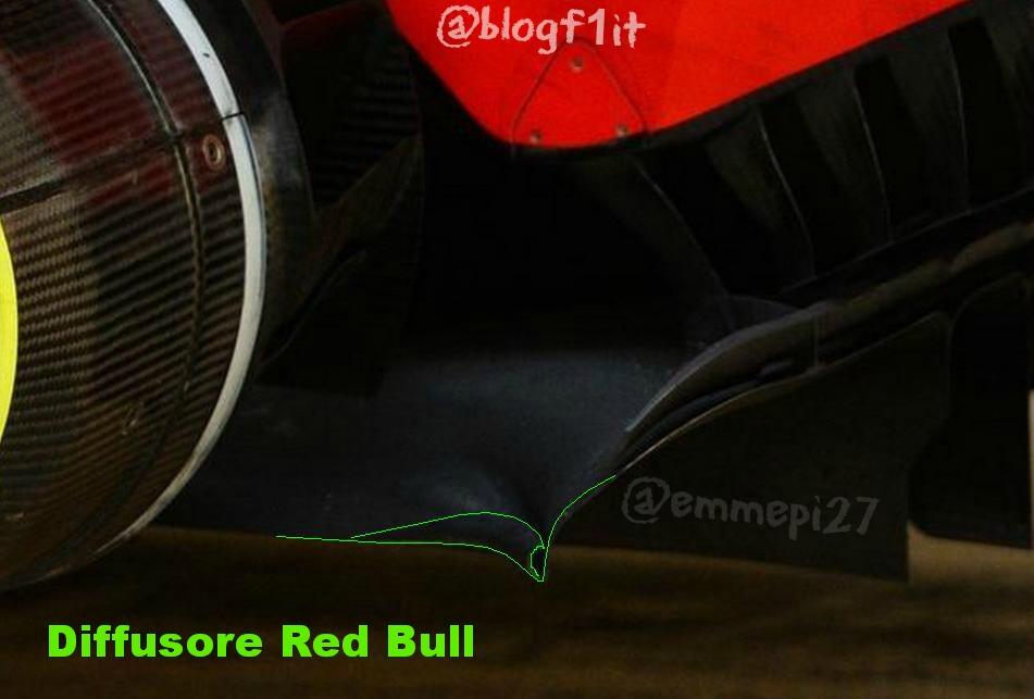

stefan_ wrote:Korea 2013 - Saturday (05.10.2013)
http://i.imgur.com/NvpISNN.jpg
Very interesting "nozzle" on the edge of the diffuser.

emmepi27
emmepi27
141
Joined: 14 Jul 2013, 12:33
Re: Red Bull RB9 Renault
Very interesting! :wtf:
