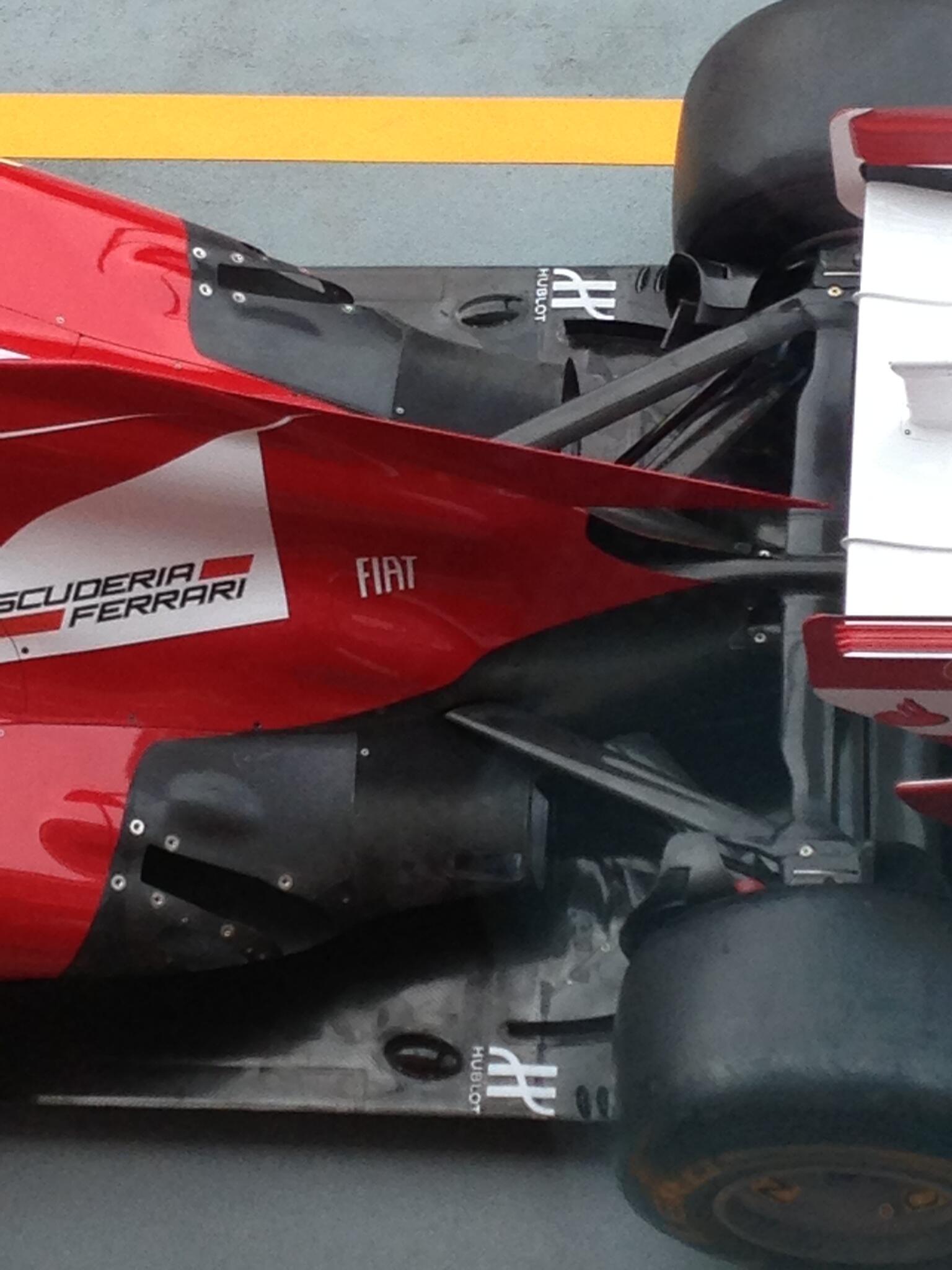

Early shots from F138 via Will Buxton:

Kiril Varbanov wrote:Early shots from F138 via Will Buxton:
do not think it was taken in Singapore, today is Wednesday, usually the installation is over on Thursday.
heimana
heimana
Joined: 09 May 2013, 15:10
Re: Ferrari F138
the teams are installing since tuesday

heimana wrote:
#-o I remain doubtful
