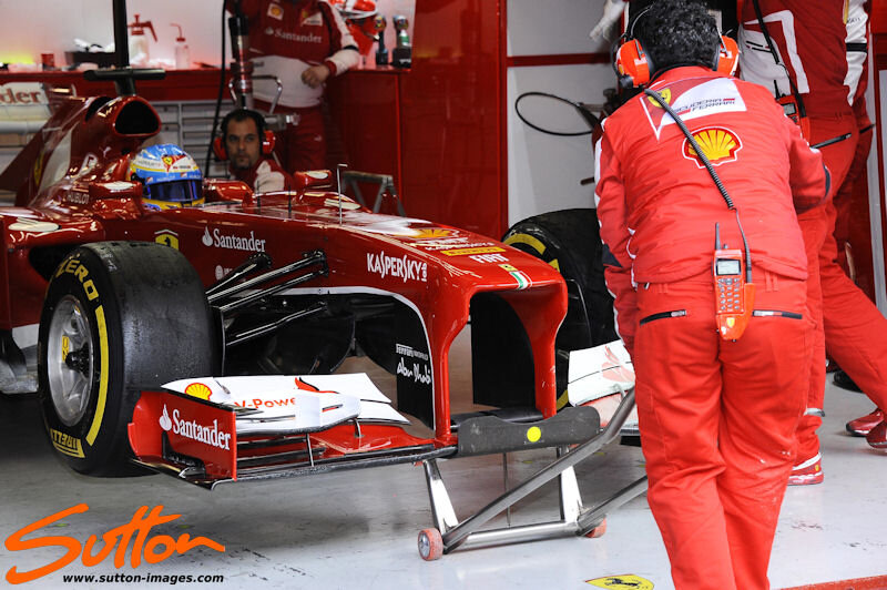

via Matt Somerfield
Matt Somerfield ‏@SomersF1
Ferrari F138 - New 7 Tier Front Wing on for @alo_oficial notice the change in Endplate & Footplate ethos
