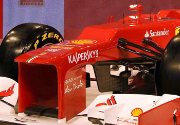

Ferrari further developed the front wing that the team were testing in the final races of 2011 and fitted these with large pillars onto a wide but very thin nose cone. The pillars themselves are positioned so that the trailing edges are closer to each other compared to the leading edges. This feature was also on the F150 and speeds up air flowing in between the pillars, and helps to draw more air towards the centre of the car.
The shape of the nose is mainly determined by new aerodynamic regulations which state that any car part ahead of the front wheels must not be higher than 55cm above the reference plane. With the front bulkhead designed to be as high as possible above the ground for better undercar airflow, a step-up in the nose was one of the most striking features at the launch, and likely also one of the most disliked.
Most striking however is Ferrari's front pull rod suspension, a feature not seen in F1 ever since the introduction of high noses. It was deemed more practical to have a pull rod, as this could run from high on the nose to low in the upright, creating a steep angle for which it was easier to setup the suspension. Ferrari though appears confident it can be done differently. With the main suspension arms slowing down at nearly 16°, the pull rod runs from the lowest edge of the nose to the uppermost end of the wheel's upright, creating a 10° angle for the pull rod. In essence, suspension travel will materialize by movement of the pull rod. Riding over a bump will pull the rod out of the chassis, something that is countered by the dampers and springs inside the car. Ferrari mainly hope that this will bring a performance advantage due to its lower centre of gravity, as the heaviest suspension components can now be placed low in the hub.
Underneath the nose there are two turning vanes, while further to the back there are small bargeboards which all help undercar airflow.
